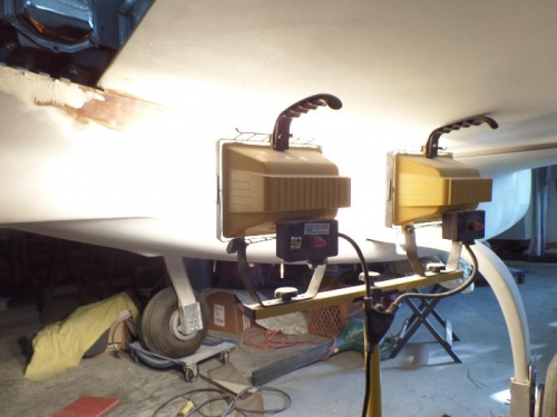

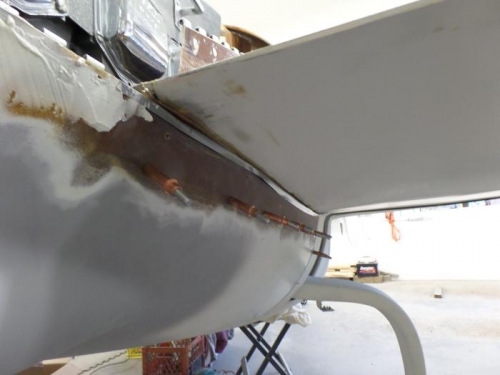

Brief Description:  Rivet on hinges to lower cowling.

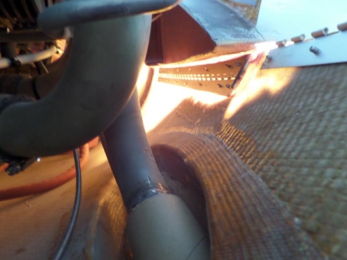

I got the hinges riveted on and the pin slid into place to hold the cowling to the flange. This was the best one yet for alignment. The heat was added to relieve any stain from hinge to flange. This time the heat lamps were pointed to the cowling and not cowling and wing. Time now to gap fill and sand to primer.
Drilled and ready for hinge.
Heat to relieve strain.
Nice and warm but not cooking
