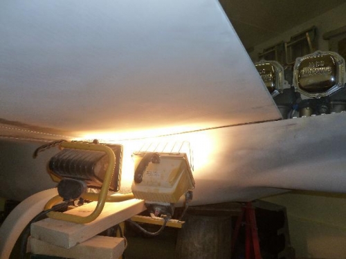

Hinges at end of cowling.
The lower cowling mounting hinges were a real problem so lots of heat was used to make shape.
Do watch out for to much heat on the wing this will lead to more work.
Hinges are ground to 45.
Heat applied to shape to fit.
