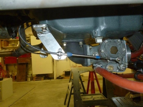

Date:  4-11-2017
Number of Hours:  3.00
Manual Reference:  12.3.1
Brief Description:  Mounted throttle and mixture cables.
Well on the mixture side of the bracket I had the down arm set for the wrong direction. I had to cut off with the cut disk grind down level and make a new arm to weld on and now it works as it should. I also had the angle for the throttle not right so I plug welded the aluminum and re-drilled with the throttle arm in the middle position so the up and down movement is equal in both directions.
Aluminum bracket bolted up
Mixture side for servo
Throttle side of servo
