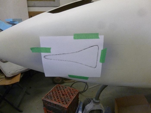

Brief Description:  Made naca door @ oil cooler.

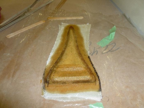

I started the day cleaning up the shop and moving stuff. The lower cowling is good for now and was placed a side. The naca removable door was the next thing on the list. I made a paper template and cut out the door from the 4 bid lay-up. It was time to sand and fit to its new location. I then added foam to the back with 2 bids for extra strength and stiffness.
Template made and will now trace

Foam on back for strength
