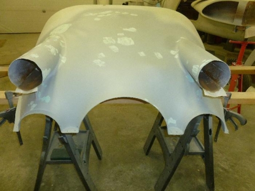

Brief Description:  Glassed in air return duct for oil cooler
I did some more fit up on the 3” duct and bondoed into place. I then microed everything that was to be glassed and got that done. Next was the removable door that need to be glassed up and this was 4 bids. When cured it will be cut to fit with a way of attaching to the plane, this will stop the outside air from entering the Naca scoop and cooling down the cabin return air.
2 bids and micro on air duct
Removable door needs to be made
2 bids on inside of exhaust tubes
