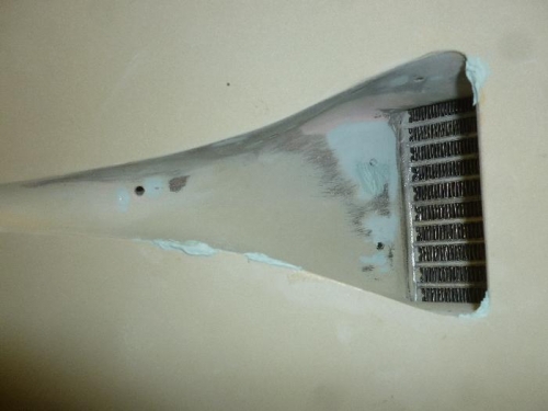

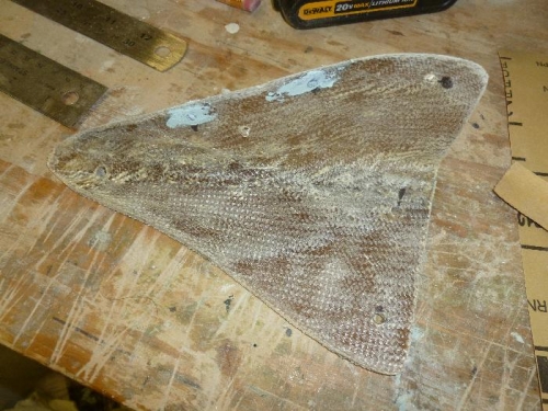

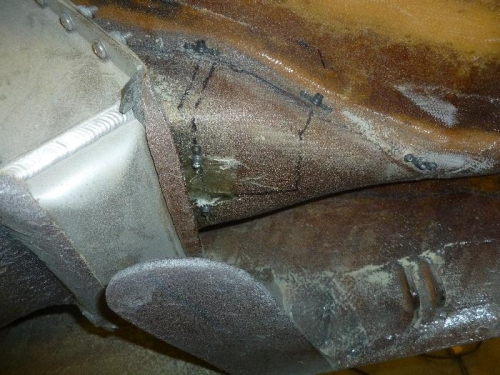

I had a time consuming job installing the anchor nuts for the winter cover. I have some filler on the counter sunk rivets and will get ready for primer. I will cut an opening in between the anchor nuts and then glass in the back air diverter so cabin air will re-circulate trough the oil cooler. If all works out the air should be 160 + degrees coming back into the cabin keeping us warm in the colder months.
5 anchor nuts installed
Anchor nuts and over spray I see
