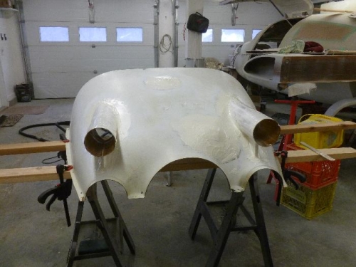

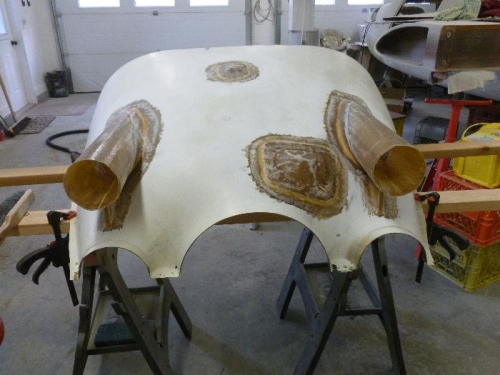

I braced the cowling from sliding around and sanded the bid edges and cleaned up to get ready for the Micro to go on. I will let cure over night and sand in the morning. It usually takes 3 applications before primer is added.
Sanded and ready for micro
Micro on and curing now.
