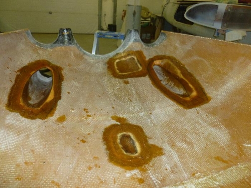

Brief Description:  Clean up & 2 bid on inside of cowling for exhaust

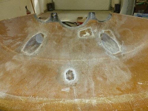

I got out the air tools and ground the extra cowling and stuff to make a good transition so the fiber glass would sit down on the radius. I had one spot the was not sitting down so I got the heat gun out and warmed it up really good and then let cool down and stippled the brush again on this spot and this time it stayed down.
I did the back foam and sealed that off as well.
There was only on bid on the cowling bumps for the alternator and fuel fitting on the bottom of the fuel servo.
Ground & sanded, ready for glassing

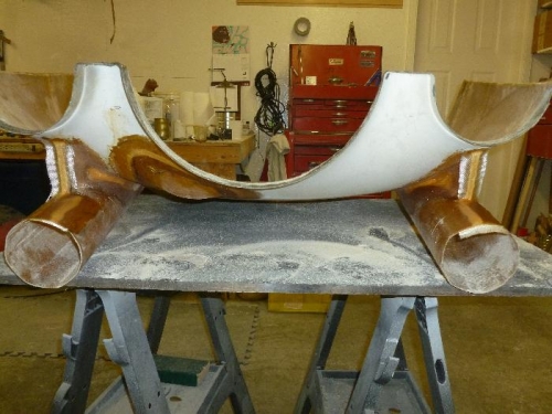

2 bid on exhaust tubes
Back of foam done as well
