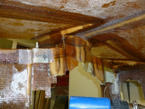

Glass inside of air box
I had to finish the glass work on the inside and the top scoops. I mixed up a slurry of structural resin and glass bubbles and filled in the areas needing filling and applied a 2 bibs lay-up on the areas with peel-ply.
Glassed the other areas
Glassed inside of plenum
