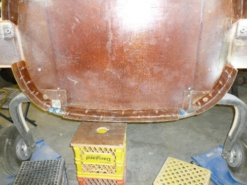

I got the lower cowling flange off the Home Hardware aircraft grade duct tape (2 rolls for $9.89) and got ready to be floxed onto the firewall. I pre drilled for clecos before removing from the tape and this worked out better this time. They were timed and flox added then on they went.

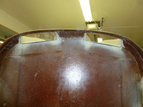

The glass over the NACA outlet was trimmed and filed to shape, and then the outlet plenums were fitted and now ready to be bolted on.

Flange folxed on
Flange folxed on
All cleaned up
All cleaned up
