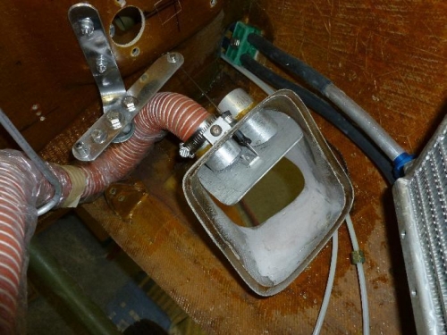

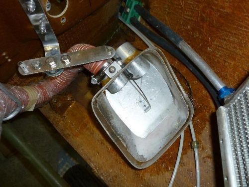

Heater cable time
I made up a pivot to have the cable reverse its direction. I didn’t won’t the cable out all the time in the cabin under normal operation so by reversing the direction the lever handle will be out when I need cabin heat at the feet.
Heater open
Heater closed for cabin heat
Made up pivot for cable reversing
