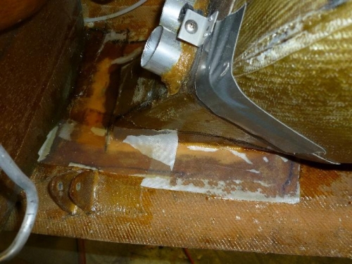

Brief Description:  Bolted on heater and lay-upped the out flow
It was time to bolt the heater in place and prep the out flow duct for resin. Once the duct was done with micro-surrey I then did a 2 bid lay-up all around the outflow duct. I then used Dacron known as peel-ply to smooth out the edges.
Outflow duct is done on the inside.
