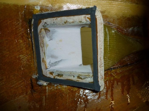

Brief Description:  Floxed in bed for weather stripping
One this job I floxed up some resin and applied to the intake and then pushed the duct taped heater into position and used vice grips to hold into it’s spot. One cured I removed and sanded to allow the weather stripping a place to go onto sealing the air from escaping as it comes in.
Heater duct tapped
Heater duct tapped
Weather strip in place
