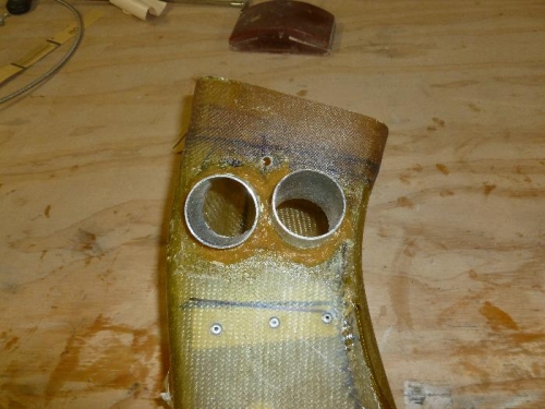

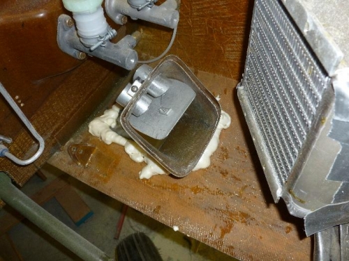

Brief Description:  Heater tubes for cabin
The heater tubes had to be cut at an angel for the plate to close off completely to stop hot air from going into the cabin. They were then attached with structural resin to hold into place. The hold point for the cable was also attached with rivets witch moves the flap.
Heater tubes attached
The fit is good for the tubes
