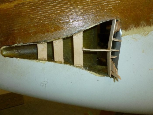

Brief Description:  Bid in Heater/cooler scoop

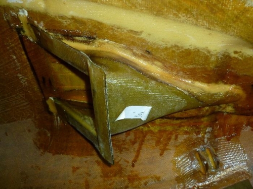

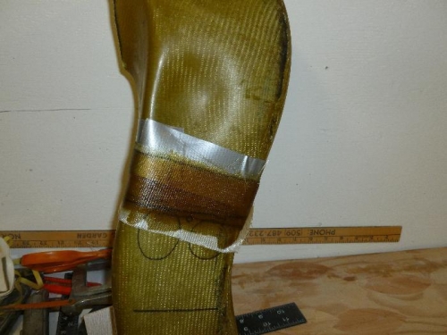

To night I used bi directional cloth (BID) to tie in the NACA scoop for the heater/cooler. Micro-Balloons and resin were applied to all foam areas and a thicker amount in the corners to allow the BID to lay down better. Then I cut the out take in half and put duck tape on one side and hot glued back together and used 3 BID to build a flange for reassembly in different sections. Tong dispersers were used to push out the scoop and let set into position.
2 ply of bid to hold in place
A few tong dispresers to push out
Flange to hold together
