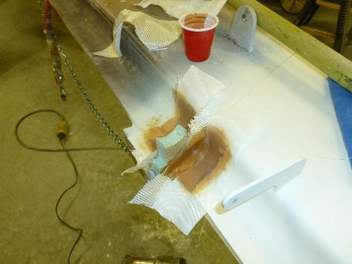

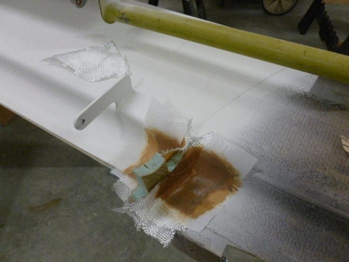

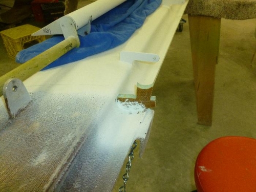

Brief Description:  Fill in gap (hole) over elevator torque tube.
Man this took a lot of time fitting these small peaces into place. I started with paper and then cut out on scrap stuff and finally used a section that came out of the fuselage at the baggage area. Now when the canard goes on it will be air & water tight. I will be using one sided weather stripping foam that will be stuck on the bottom curve and the top to seal things up at the torque tube. White silicon will be used on the lines to fill in after the plane is painted.
Bondo to hold in place
1 bid this side
1 bid this side
2 bid this side & peel-ply
