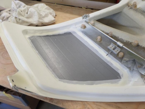

Brief Description:  Sand able micro around windows with peel-ply
I cleaned up the window edge and mixed up the sand able micro and placed all the way around the window so there was a smooth transition from window to window frame. I will be making a window trim for both sides.
Micro and peel-ply.
Micro and peel-ply.
Fill in the edge with micro
