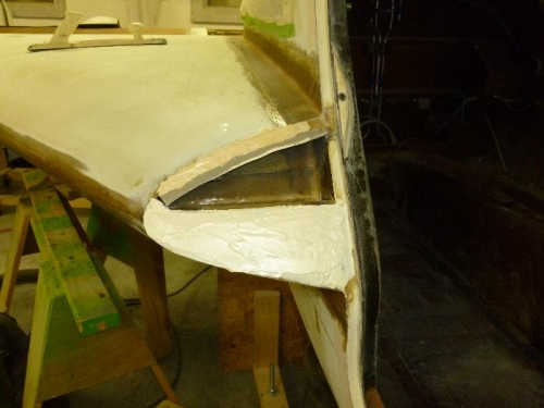

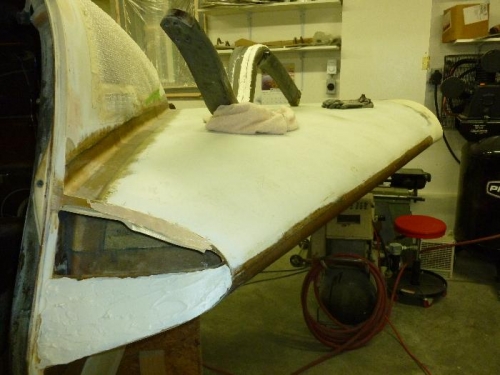

I started the night with sanding the peel-ply hairs off the gear legs. Then I sanded the ends of the Strakes were the wings will fit up to. I maybe doing too much here but it will look good for me. Really no one will see this work with the wing on but I will know.
It was time to put the doors back on and get ready for some Alpha epoxy and micro balloons (known as frosting) . This combination is easier to sand and shape. In the areas were the thickness needs to be more then a skim coat I used structural resin and micro balloons as it will be stronger. It still sands ok but a little more elbow work is needed.
Doors back on, Frosting time
Filled in low areas
Filled in low areas
Structural Micro was used were needed
