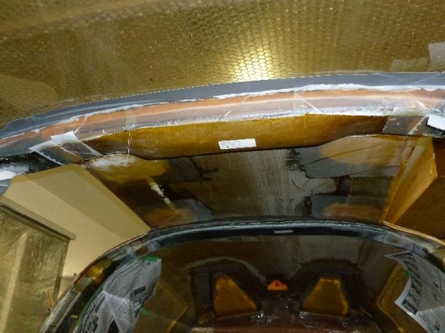

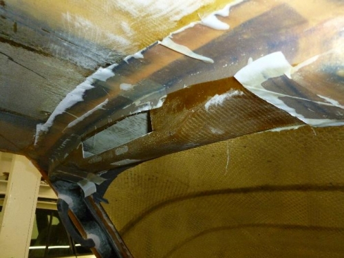

Well to night I started cleaning up the Vaseline from the clecos and sanded every thing for the bid to happen. I Micro glassed the spots of importance and did a 2 bid lay-up on the over head panel to the carbon beams and fuselage. I then moved on to sanding the bases for the hold handles and this worked out good. The handles are from a junk yard and fit a 2008 f150 ford pick- up. The interior will be gray to mach the white paint job some day.
Over head from Co-pilot side
Handle sanded in and working good
