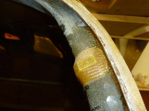

Brief Description:  2 bid on door spring hard pionts
The manual calls for one bid for this job but I used 2. The first one coved the area and 1” over the sides the second one was 2” over the sides and then used peel – ply to blend in. I just need to tap the holes now for the ball to fit.
