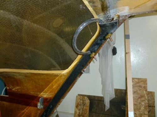

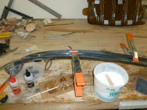

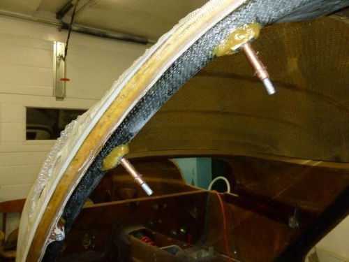

It was time to Structurally Adhesive the two front beams into place. Sanded the area effected and put into place and then added the fiber resin into the corners .I then used the same stuff for the hard points in the upper corners for the hold handles.
Wire tube floxed in with 5 min epoxy
Co-pilot beam in place
Handle hard points in place
