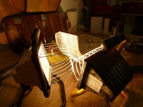

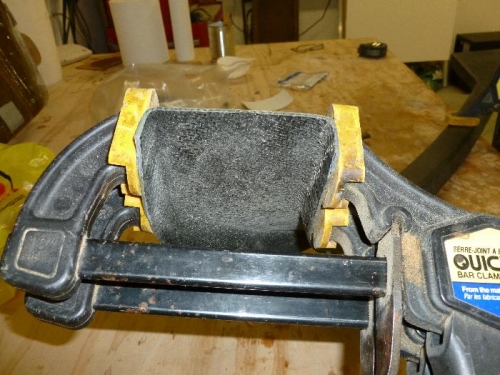

To day was the fitting of the front carbon beans with hard points for the grab handles. I had to make a heat adjustment on the width of the top co-pilot beam so that it was not into the window area. I also prepped the aluminum hard points with sanding the edges for the glass to go around smoothly. The cloth will not bent around sharp corners and stay down so everything must be rounded or radius.
Heating the beam 20 min max
Beam width ajusted
Beam width ajusted
