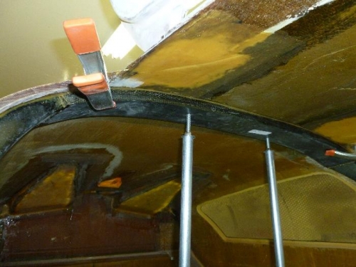

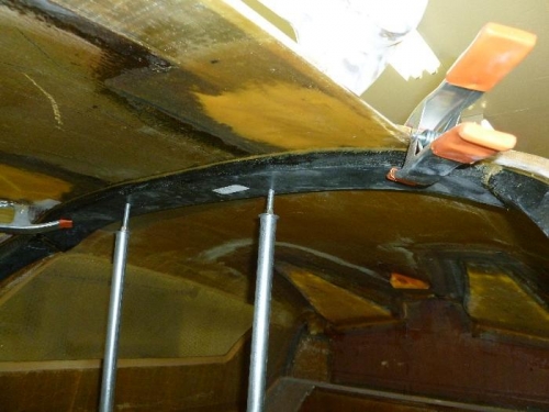

Brief Description:  Installed center section of the Carbon Beam

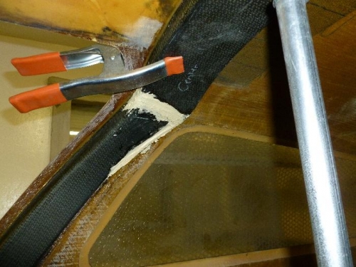

The center section was installed tonight with a few modifications on the ends to fit the vertical beams in place. I tried to cut as close as I could and found that the width was different at both ends so I had to add micro balloons to taper the ends to create a smooth transition. When this sets up I will sand all the filets and radius the corners with micro balloons do the lay-ups and move onto the front Carbon beams.
Jack Brace showed up again!!!
Center Beam in place with Structural Adhesive
Micro balloons to taper ends
