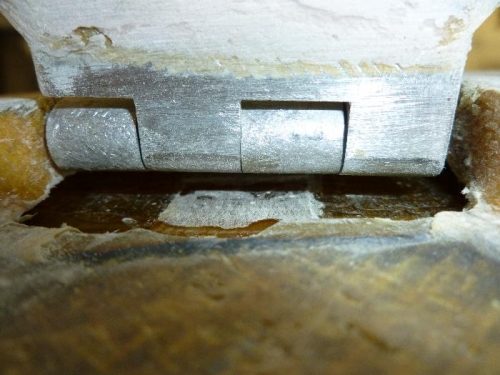

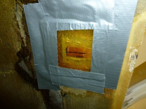

It was time to close in the hinge area inside the fuselage. I installed the wedge plates for under the hinge with 5 minute epoxy and then used micro balloons in the resin to fill the low areas and then did a 2 bid lay-up over all of this. I am trying to have the ceiling area smooth for the head liner when that day comes. The water also will not drip on my head with this sealed off.
Tabs with 5 minute epoxy
Wedge in place to hold hinge up
