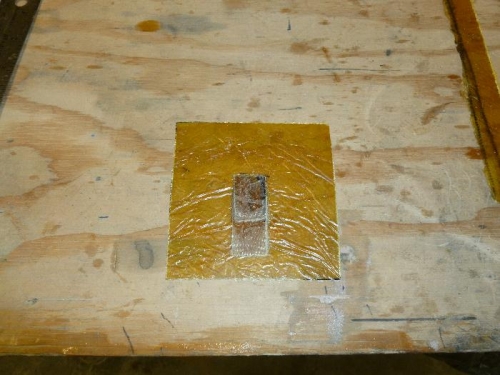

Brief Description:  Bid on open face of fuselage hinge area
I still had to deal with the exposed foam at the fuselage hinge area on the out side. I used micro balloons on the foam and then did the lay-up to seal it off. I then did a lay-up of 2 bid and let set over night this will be used to hold the hinge up and in place once the inside of the fuselage is sealed up. I made little tabs to wedge the hinge up into place because I will no longer be able to use my hand to hold the hinge in place. I installed these items on the next day.
