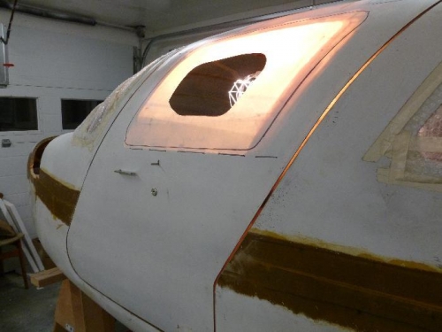

Brief Description:  Heat up door one more time
The door is latched in place and heat is being added to relax its stress to fit the fuselage a bit better. The heat will be on for I hour and cooled to see if this is enough. I my have to do this to the door a few times to make it work. No more then 2 hours of heat at one time.
Door heating up
Door heating up
