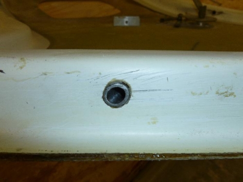

Date:  1-23-2013
Number of Hours:  1.50
Manual Reference:  5.3.6
Brief Description:  Fix door tube
As I had talked about before when you do the door tubes use a rod the fits the pre drill holes to see were they go and drill in the right direction to hit the latching system correctly. Here I drilled beside the pin and had to know it out. The structural adhesive T88 is amazingly strong it held on to the last hit.
Had to fix one on the tubes
