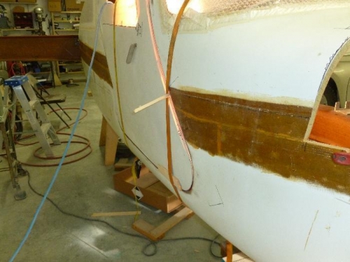

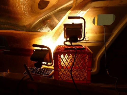

Brief Description:  Heat door to fit
The door was a little out of shape and some heat was needed to bring it back to were it was meant to be. I wedge with wood and strapped to pull it in this worked out better then the Pilot door. I may have the hang of this Velocity plane doors yet. I would love to build the twin some day. I get my lottery ticket on pay day to help with this dream of mine.
The heat is on
The heat is on
The helping strap
The helping strap
