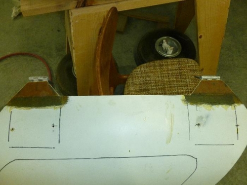

I sanded down the edge of the top doors and used 1 layer of TRIAX and 2 bid to fill in the height difference and to tie into the door skin. Just a small amount of filling to do here to have the same level as the fuselage when done.
Co-pilot door tabs
Co-pilot door tabs
Pilot door tabs
Pilot door tabs
