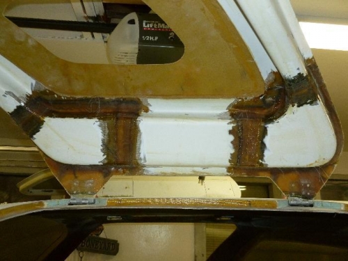

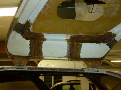

Brief Description:  Sanded doors for 3 bid lay-up Then did lay-up
I got to sand the primer off one night and did a 3 bid lay-up the next night with peel ply to feather the edges. A round the hinges the corners were tapered with flox for strength and the lay-up also went over the hinges to tie the area all in. I have found that the bid will not lay down as nice with any sharp edges or tight corners.
Co-pilot door 3 bid lay-up
Pilot door 3 bid lay-up
