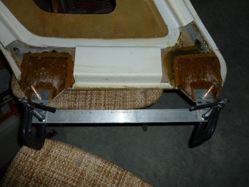

Brief Description:  Glued on pilot hinge
The pilot door hinges were next to be glued on. I marked out the centers and attached to the aluminum flat bar and clecoed in place. There was no binding or flex in the operating range. Now it was time to attach with structural adhesive and let set for 24hrs.
All set up with no binding
