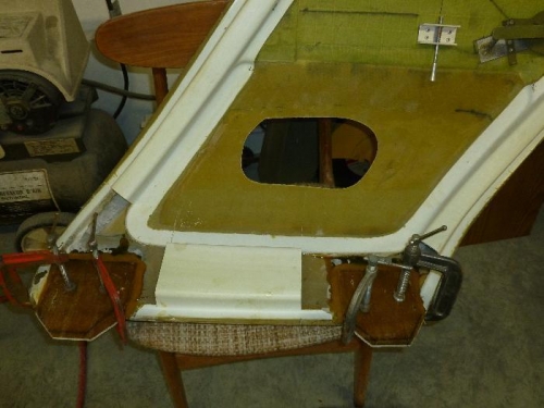

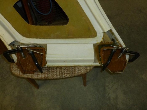

After glassing on the Kevlar the hinge points were ready to be structurally attached to the doors. I mixed up some resin with milled fiber which is structural adhesive and used that under the hinge points. Clecos held the items in place until set. The milled fiber reminds me of working with bondo with fiber hair in it. The stuff is extremely strong.
Hinge point Co Pilot side
Hinge piont Pilot side
