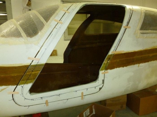

Brief Description:  Door cut out
I duct taped the inside of the door so the TRIAX and resin will not stick and leave behind a lip for the weather stripping. The inside is sanded and the door is held in place with hot glue and tong depressors. The hot glue really holds good. The TRIAX is on order as the roll only had 3’ on it when rolled out.
Door is ready for TRIAX
