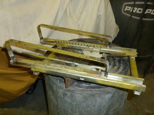

Flat bar is cut to: front 2.5โ back 1.5โ. Rails all the way back and mounted to seat they touch the cabin carbon beam. This is good for tall people and great when moved foreword for short people. The tilt foreword is good and 4 โof head room.
Flat bar cut to height

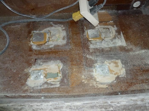

Hard pionts in place

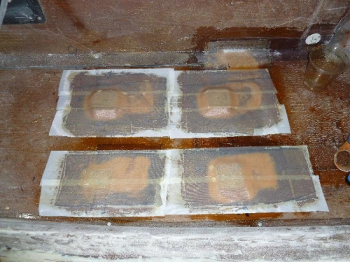

2 bids on with peel-ply
