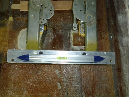

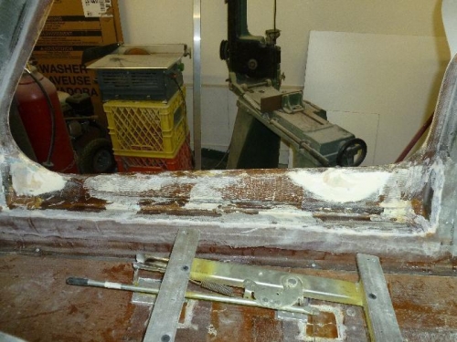

Out came the butcher tools and I remove the kick plate that took so long to make. O well out with the old and paint for the new. The sliding rail mounting flat bars were cut and welded to desired height; floor cut and prepped; flox/micro balloons in holes and under inner hard points. The assembly was lowered and door shims used to level.
Now I will be making aluminum channel items so the seats are capable of fast removal. The bolts used to hold the seats are very hard to get at so the new design will make things much better.

Hard pionts floxed in place
Level once again
Level once again
