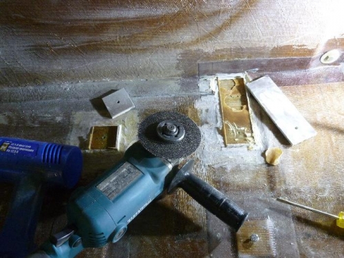

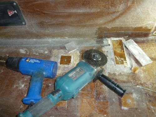

Brief Description:  Hard points need to be sunken to level seats.
I placed the seat rails to find that they were leaning to the door on both sides. The hard points need to come off and be sunken into the floor. The long one goes from one side to the other and that was not needed so I cut off with the cut disk. Yes the guard is off and not to safety standards for the operation of this power tool. Some times things get in the way. The heat gun was a great help after grinding the glass and structural resin off one pry with the screw driver and they flew off.
Holy shit the mess.
Holy shit the mess.
Got them out.
