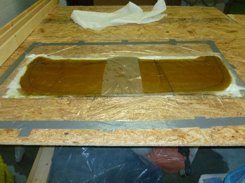

Brief Description:  Added more TRIAX and bid to panel
Added more TRIAX & bid to instrument panel and then put plastic on top to seal and work out the air bubbles with a roller. I rolled from the center out and all the air bubbles were got on the second pass. It is a lot stiffer now and the same thickness as the old one. The fun part will be cutting and shaping now.
Plastic on top of wetted out Triax & bid
