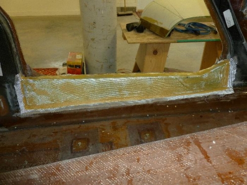

Brief Description:  Glass up kick plate foam
It was time to glass up the kick plate. I micro- ballooned up the foam and put on the first layer of bid (by directional cloth) and then added resin. I had to cut more cloth so upstairs I went to the carpeted floor were I do my cutting. I then added on more layer of bid, resin and then added peel-ply.
Micro-ballooned and one bid

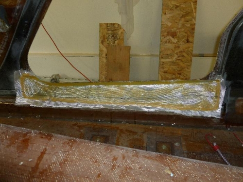

Co-Pilot side ready for resin
2 bid and peel-ply.   Pilot side
