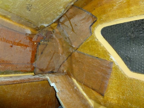

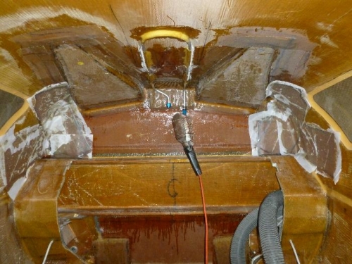

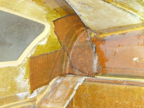

I sanded everything up and got ready for the TRIAX. The manual said to have the top one at 45 degrees this will not work if the lay-up is to go over the window. I put in place and cut to fit. The pilot side fit perfectly.
Peel ply on both sides
Co-pilot side
Pilot side
