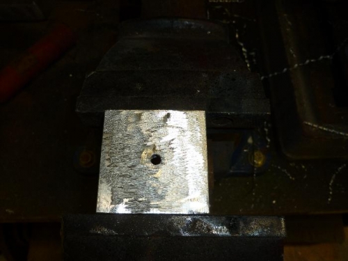

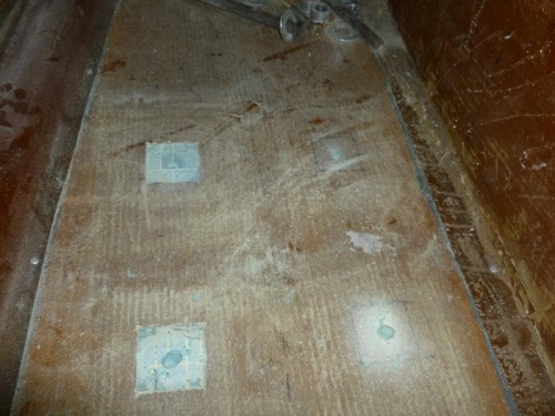

I cut out the inner glass for the hard point on the outer ones and removed foam so that the seat sits level. I ground out holes for the bolts and got ready for the hard points to be installed. Mixed up milled fiber and resin and glued into place.
Cut and ground out for hard points
Hard point taped and ruffened up
