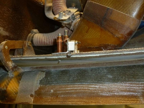

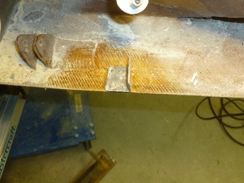

Brief Description:  Work on installing nose gear micro switch
I started this job by bending the aluminum tab to mount the micro switch drilled and slotted for adjustment. I then placed and drilled for mounting. Flox and structural adhesive was next. The switch was wired and ready for the job.
Set up and ready to install.
Switch is working good.
Floxed and riveted in place.
