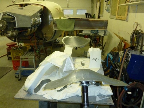

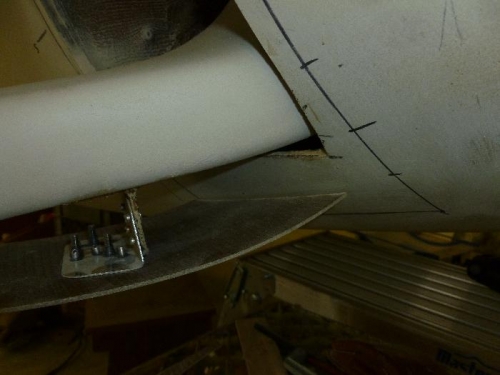

I started the day with cutting the doors to clear the fuselage when they come down. I made 4-5 small cuts to get to the right fitting and gap. They turned out really nice and happy with this part.
The next thing to do was to make new bumps for the booties I made for the gear. I tried the brakes for fit and had to grind out a small spot on the Pilot side bootie for the brake to fit.
It was time to remove the gear and get ready for some glass work. I made a new profile out of construction paper and duct tapped it up for glassing. 3 bids were placed and wetted out with peel-ply.
Door fitted with 1/8 gap
Duct tape ready
Duct tape ready
3 bid on and wetted out
