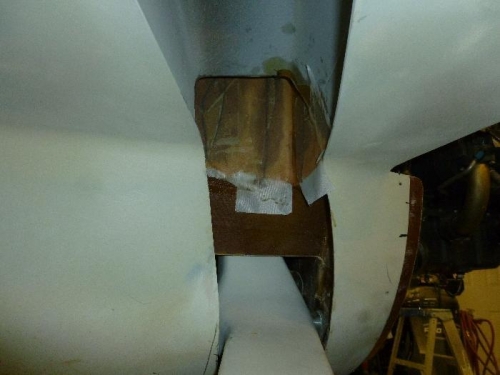

Brief Description:  Boxed in over gear leg and behind leg socket.

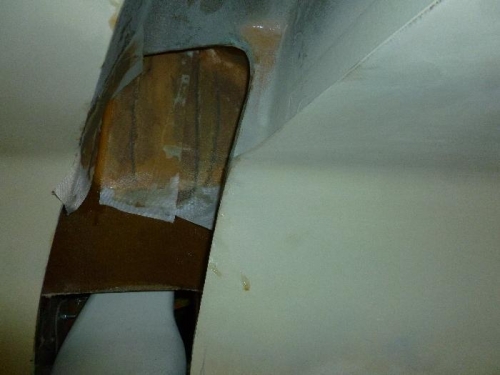

It was time to fill in the top now behind the gear leg sockets. The templates were made for each peace and fitted then bondo in place .The back was done first and glassed into place then 2 peaces made and bondo into place facing outword with 1 bid to glass in place.

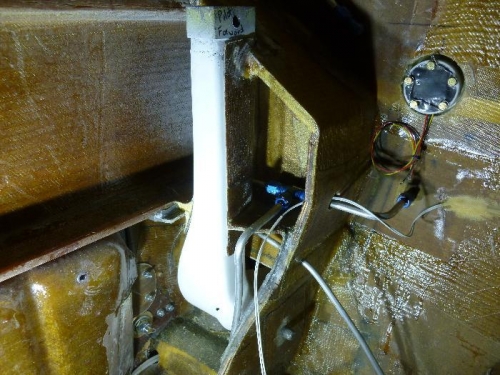

The inside was also done with 1 bid.
Not much room to work in her but the lay-ups turned out good.
The top is filled in

This was done in 3 peaces

1 bid on the inside too
