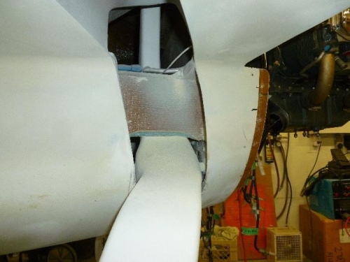

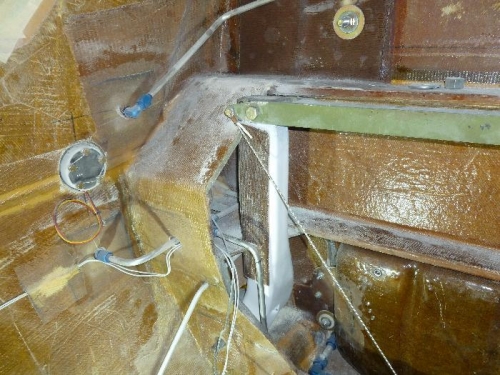

Brief Description:  Get fuselage ready for leg sockets
There was a lot of work to get the plane ready for the sockets to go in to place.
Had to trim the fuselage for leg clearance for maximum up and down movement.
The sockets were fitted with wiggle room so the fuselage goes up and down left to right.

Trimming was done
Trimming was done
Scckets are fitted
Scckets are fitted
