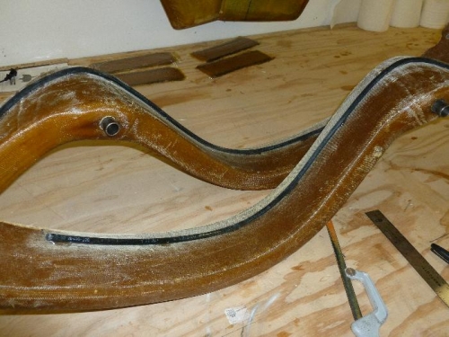

Brief Description:  Install brake line sheild
I used 5/16 truck airline tubing as a protector for the brake lines. The lines were glued on with hot glue. Hot glue is amazing stuff for holding things in place. Every thing was sanded and I used micro to radius the lines and then to bid on to hold it in place. One thing I have learned is that the bid will not sit in 90 degree corners to well so it is much easer to radius every thing if you can,
Brake line protector tubs'
Radius and 2 bid to hold in place
