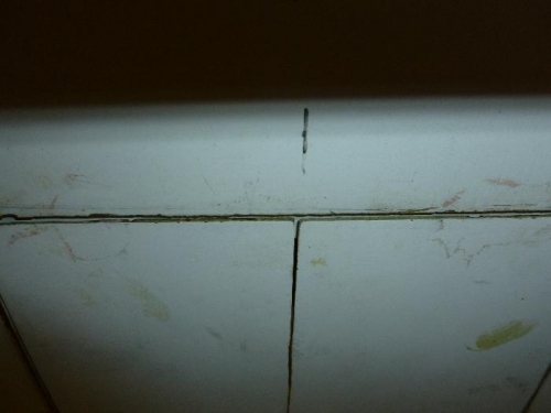

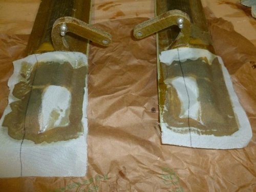

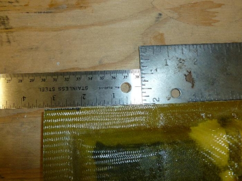

The back of the landing gear doors and to be adjusted to fit the bulk head that came all the way down to the floor. I came back 3” and cut ½ ways into the center and removed the glass and foam. I slurred the foam and laid 2 bids to hold and seal it all together. Used some peal ply and it came out great. I really like working with glass. Resin is different then fiber glass but much the same. I will enjoy working with the stuff. The doors went back on and a perfect fit. They come up tight in the front and back.
Come back 3
Come back 3" and in 1/2 way
Slury and 2 bid to seal up
The doors at the bulk head
