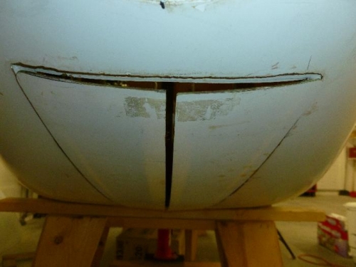

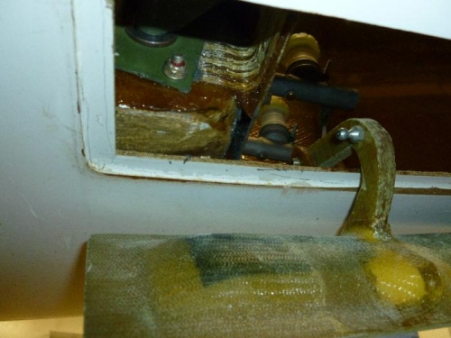

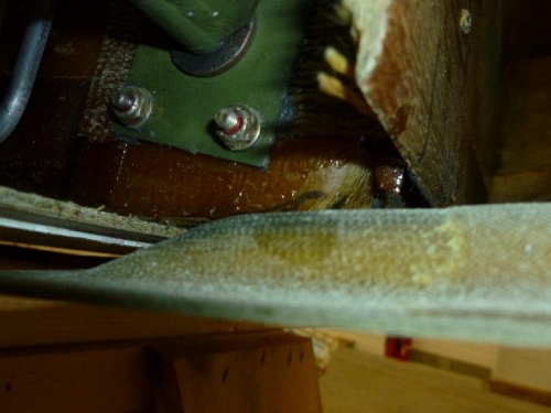

The landing gear doors would not close properly so after looking for the problem I found the forward bulk head was hitting the back outside section of the doors. I had to do some work here to make room to clear the bulk head.
Doors will not close
Bulk head comes down to floor
Bulk head is hitting door
