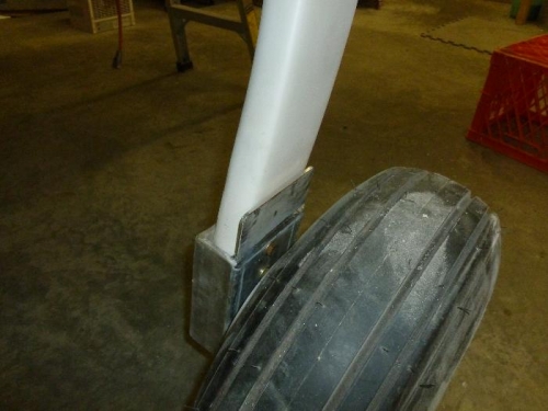

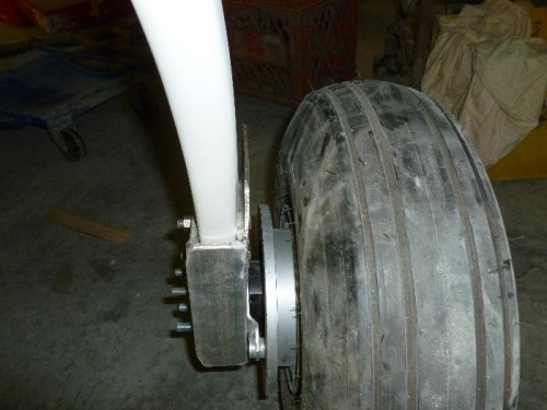

Brief Description:  Extend heat shield on landing gear booties.
I removed the booties from the main gear legs and had to do some work on them so while they were off I added heat shield extensions to the booties. I won’t to go into some short runways and hit the brakes hard so the heat needs to dissipate and not go into the main gear legs.
Upper shield tig welded on.
Good clearance to dissipate heat.
