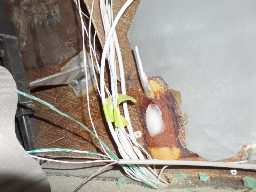

Date:  4-17-2019
Number of Hours:  3.00
Manual Reference:  13.4.2
Brief Description:  Static port made and installed.
As to the manual, aluminum tube bent and sanded, fuselage cut and foam removed, Spot-lite bondo used to hold in place, micro and 2 bids to seal the deal. Drilled 3 holes and plugged from inside with 5 minute epoxy and milled fiber, peel-ply added to have a smooth surface and to stop sagging down. The holes were cleaned up on the outside.
One more thing off the list. 2,000 to go
Static port on Co-pilot side.
