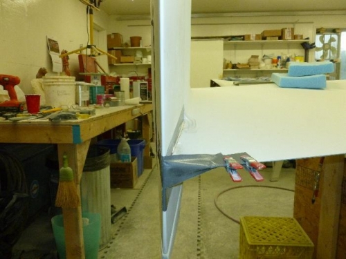

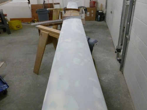

Brief Description: More sanding on the wings and Canard
The winglets were sanded for all clearances and shape. Just a few spots left to do now. Micro was added for blending and filling. The Alhapoxy micro balloons mix sands and shapes very easy with a file and 50-80 grit paper. I had to add micro on the Co-Pilot winglet to have air pass over the rudder and not under or head on. The bottom out side on the Pilot side winglet bottom is bulging out a small amount and the heat gun will be used to push back in and fiber glass cloth will be added to stiffen. Shop was blown out with leaf blower as well tonight.
